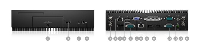

Dell er með svona rugged línu , 2 model Embedded Box PC 3000 og 5000, rack mount , CAN bus kort, 2 x serial port sem hægt er að breyta í RS232, RS422 eða RS485 í BIOS.
https://www.dell.com/is/business/p/embedded-box-pc-3000/pd
Ports & Slots
1. Access screw | 2. USB3.0 | 3. Reset button | 4. Power button | 5. Antenna SMA connectors | 6. Dual Gigabit Ethernet | 7. Display Port++ (DP/DVI/HDMI) | 8. USB2.0 | 9. CAN bus card (optional) | 10. VGA | 11. Other Dual Gigabit Ethernet | 12. Multi-function port (attaches to 7-in-1 cable: 12-bit GPIO, PS2 keyboard cable, PS2 mouse cable, IOIOI 2 serial cable, RCA line, RCA line out, RCA microphone) | 13. USB2.0 | 14. Serial ports, set by BIOS to RS 232 or 422 or 485 | 15. Phoenix-type remote power switch | 16. Locking DC connector | 17. Antenna SMA connectors
