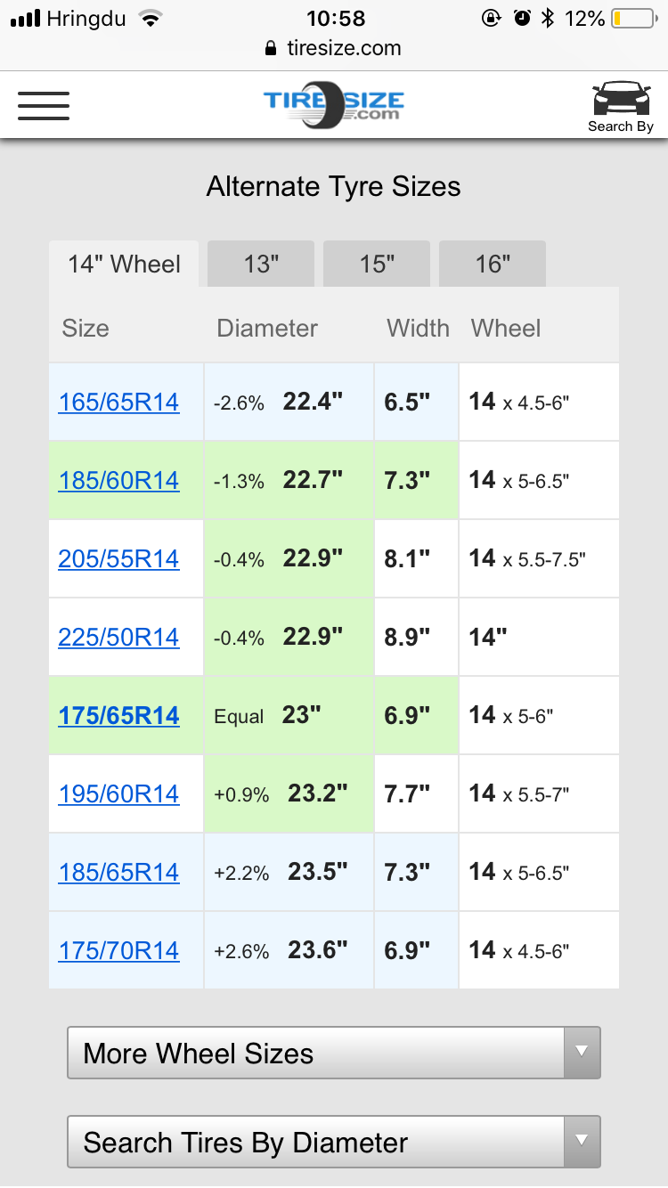

Grænu passa:
https://tiresize.com/tyre-size-calculator/
