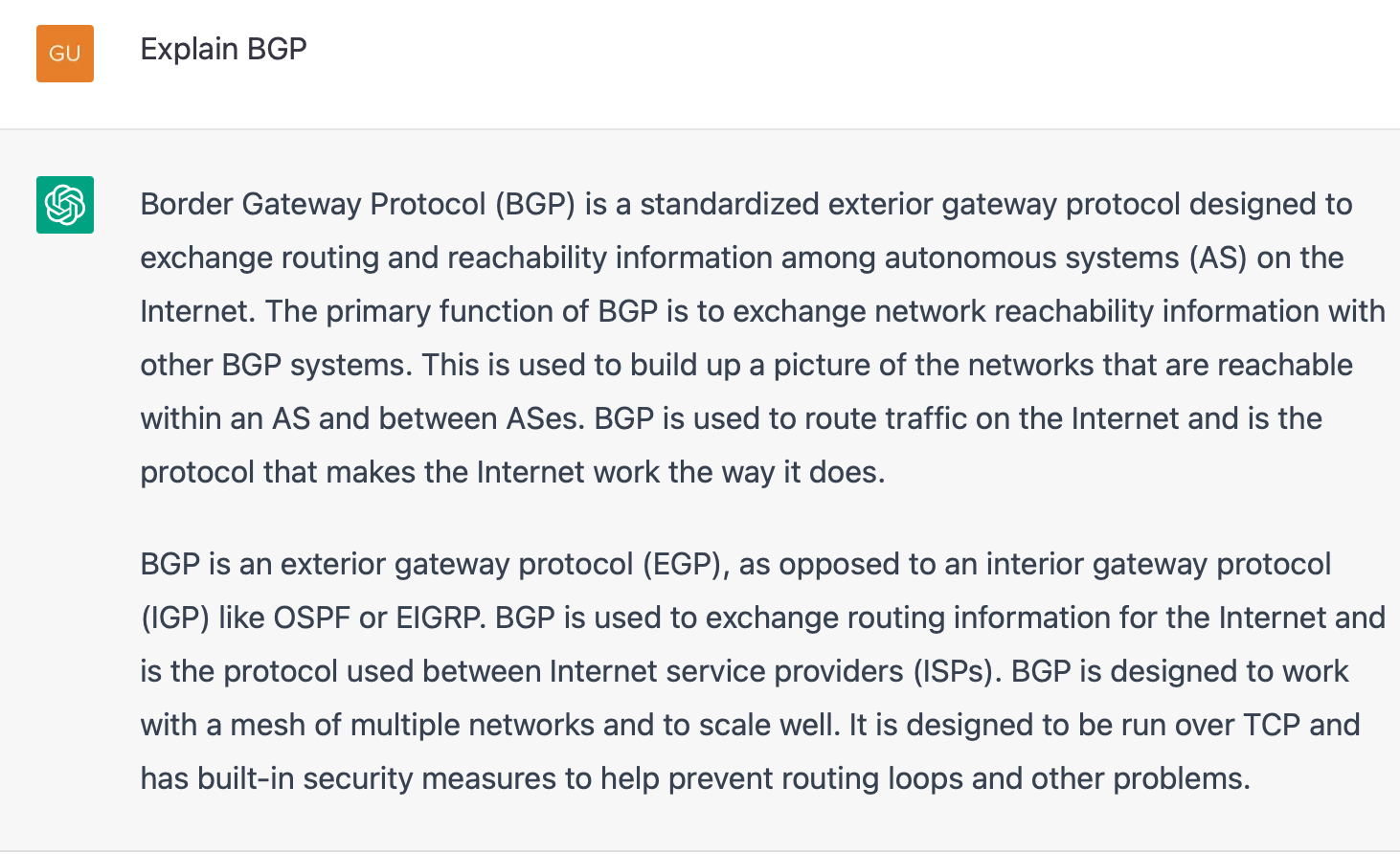

Pósturaf GuðjónR » Sun 08. Jan 2023 17:23
:happy
Screenshot 2023-01-08 at 17.21.55.png (228.3 KiB) Skoðað 2924 sinnum
